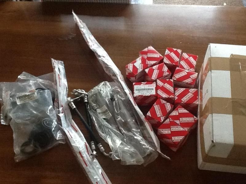

- - Nial   Well got a bunch of tstuff back from the zinc plat...   May 18, 2014 - 9:55 AM
