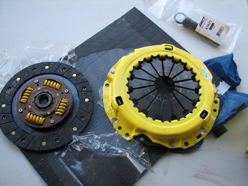

my clutch is the ACT TC2-HDSS ...
me thinks it good stuffs.. definitely an improvement over stock.. worth $300... just shop around
