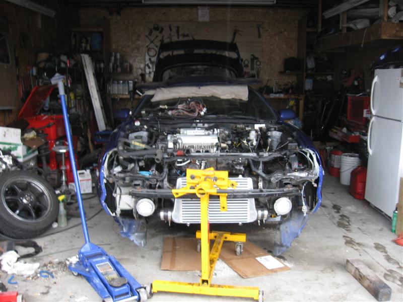

motor is finally off the stand.
WOOT.
ill reinstall the clutch later today, dustin is comin by and we'll get the motor in and start buttoning her up.

a pic of the progress from yesterday, i havent had a chance to get out there today, ill get out there for a while tommorow and start refabbing up the oil lines again ect.
