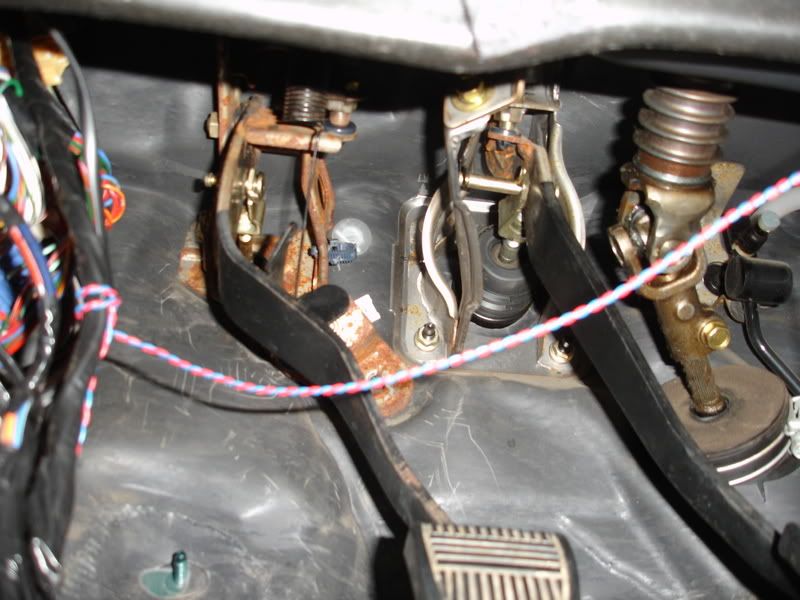

- - hurley97   ITS DONE! FINALLY! thanks to JDM guy,...   Aug 9, 2006 - 9:06 AM
- - presure2   JDM guy, yo! haha a few notes for future refre...   Aug 9, 2006 - 9:17 AM
- - hurley97   a few pictures. i have some more detailed ones...m...   Aug 9, 2006 - 10:06 AM

- - hurley97   Alright, I didn't take too many pictures but h...   Aug 9, 2006 - 8:32 PM
|- - alltracman78   QUOTE(hurley97 @ Aug 9, 2006 - 8:32 ...   Aug 9, 2006 - 9:41 PM
|- - hurley97   QUOTE(alltracman78 @ Aug 9, 2006 - 10...   Aug 11, 2006 - 9:23 AM
|- - alltracman78   QUOTE(hurley97 @ Aug 11, 2006 - 9:23...   Aug 11, 2006 - 7:55 PM
