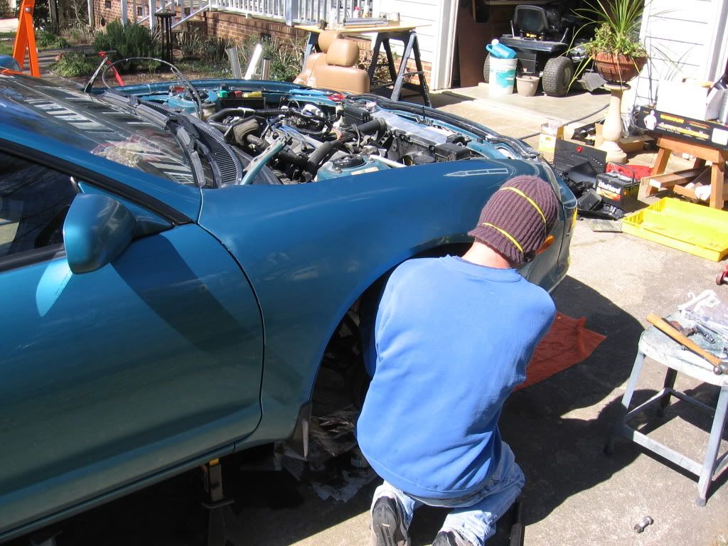

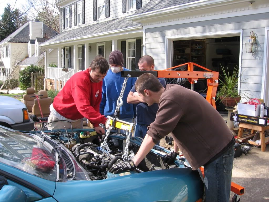

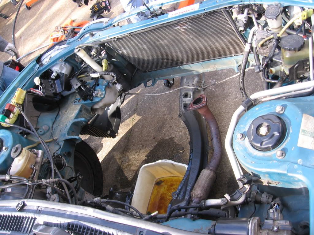

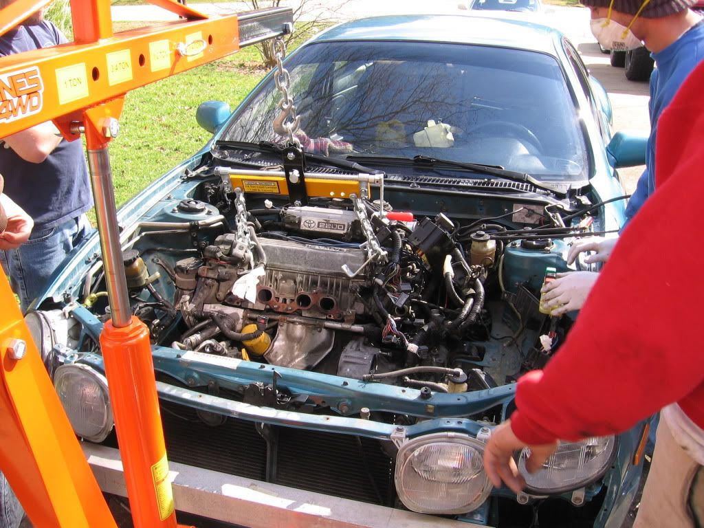

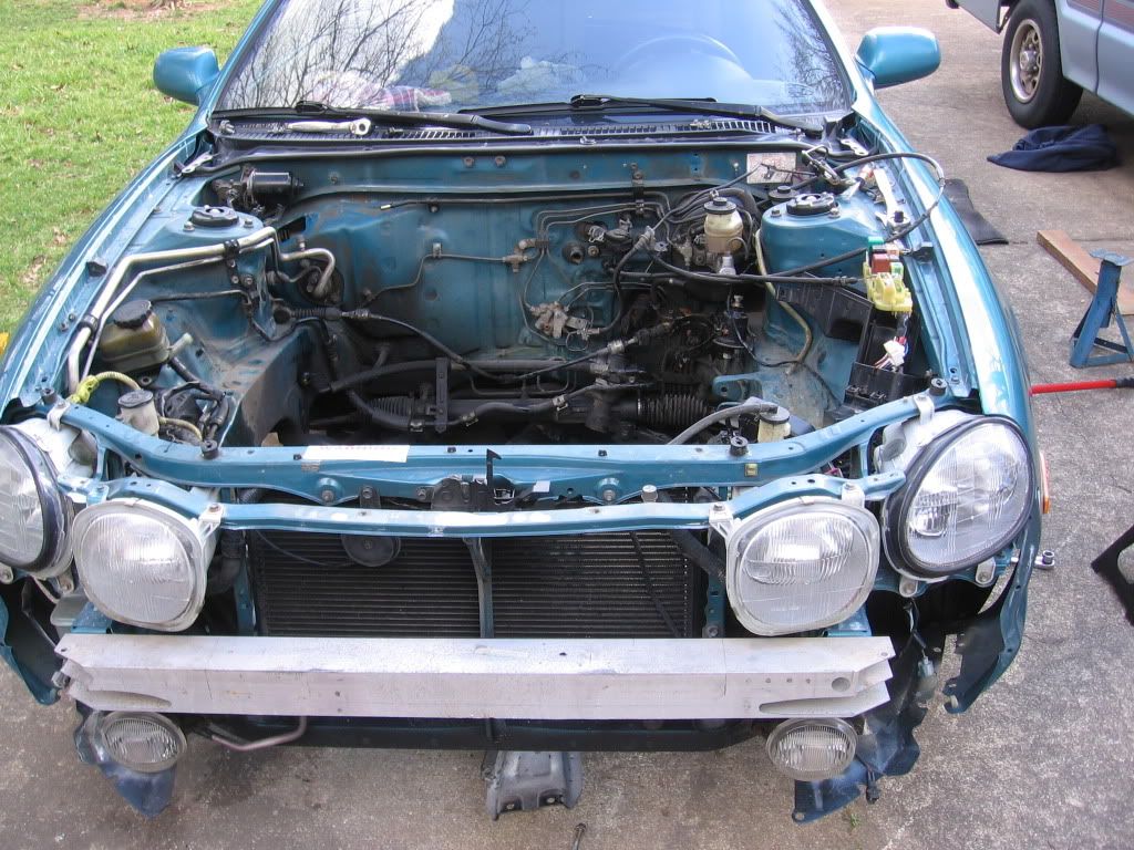

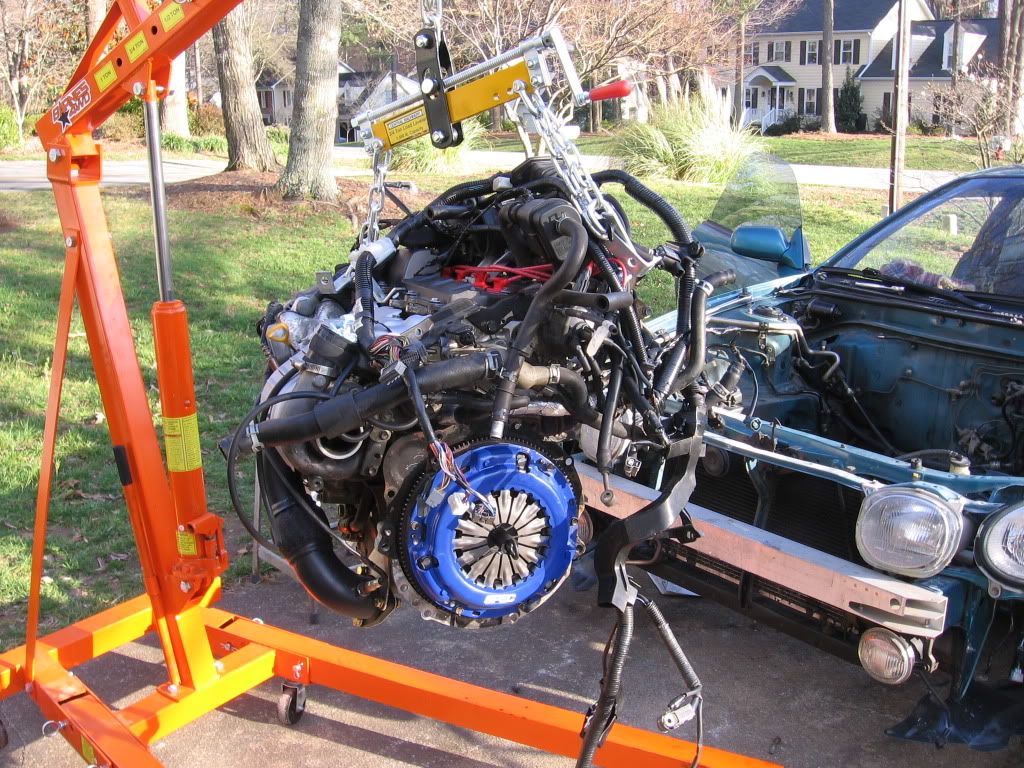

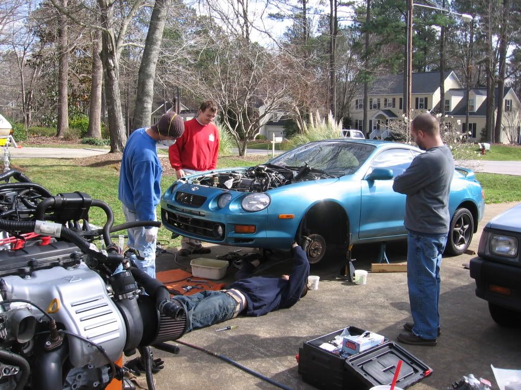

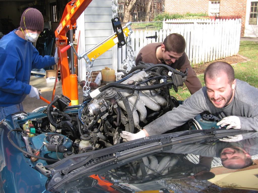

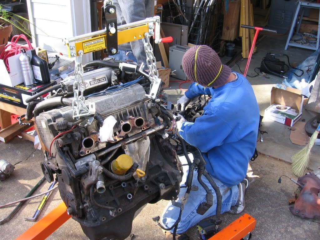

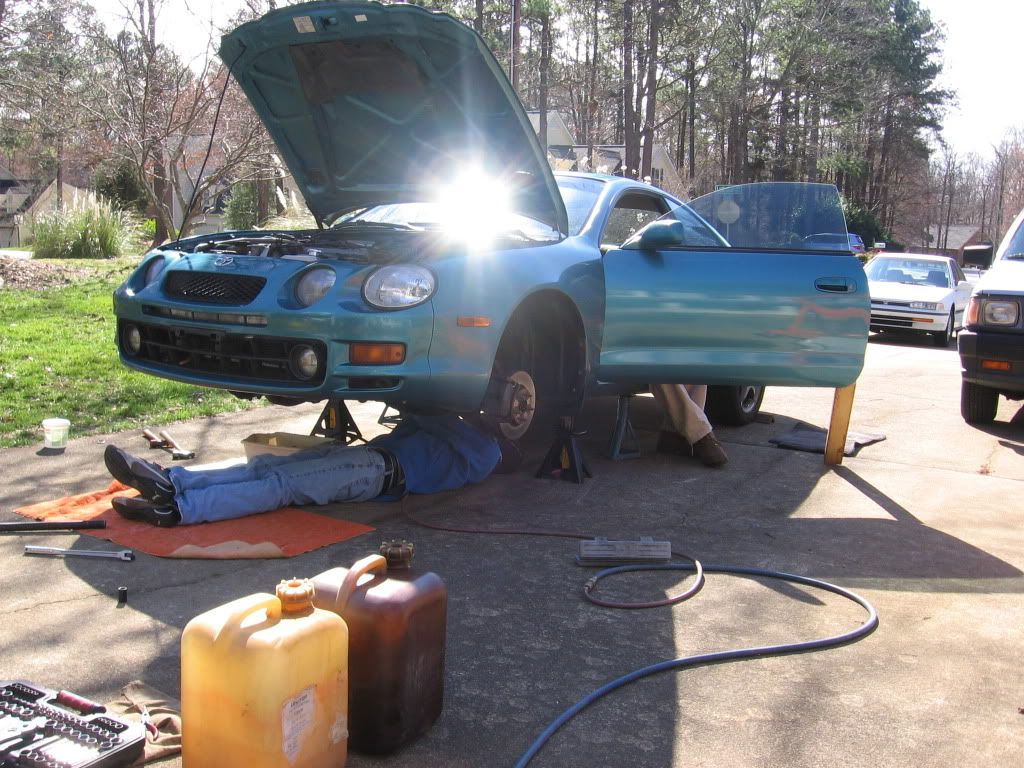

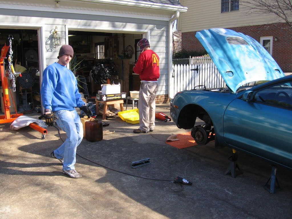

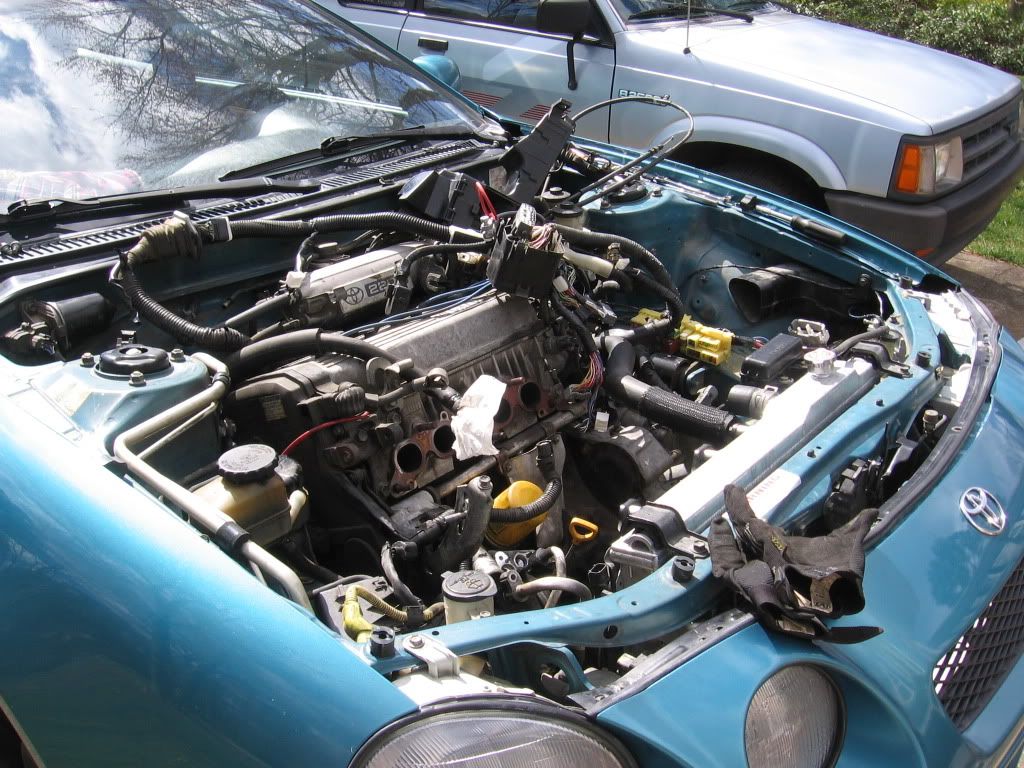

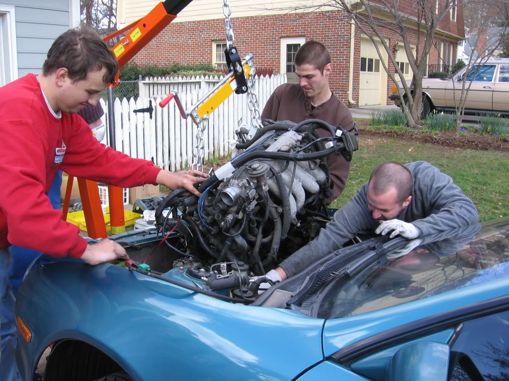

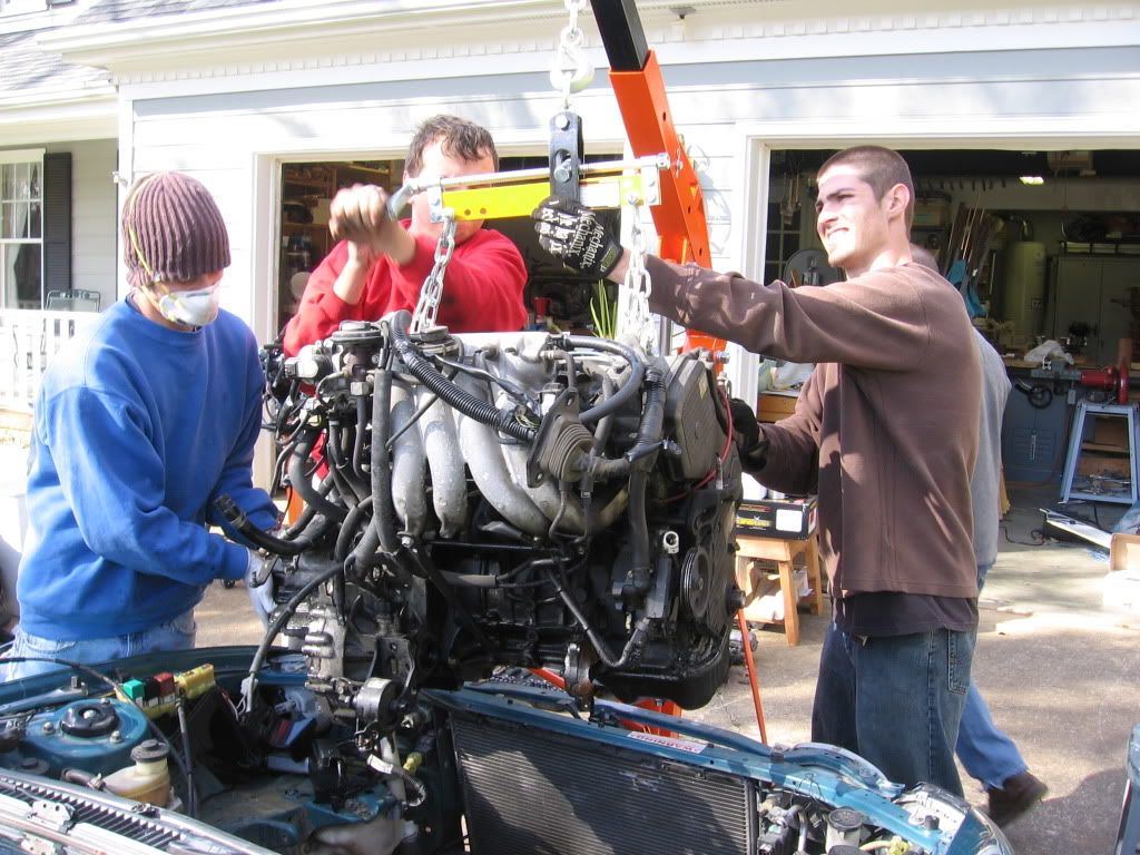

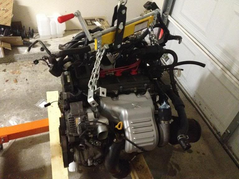

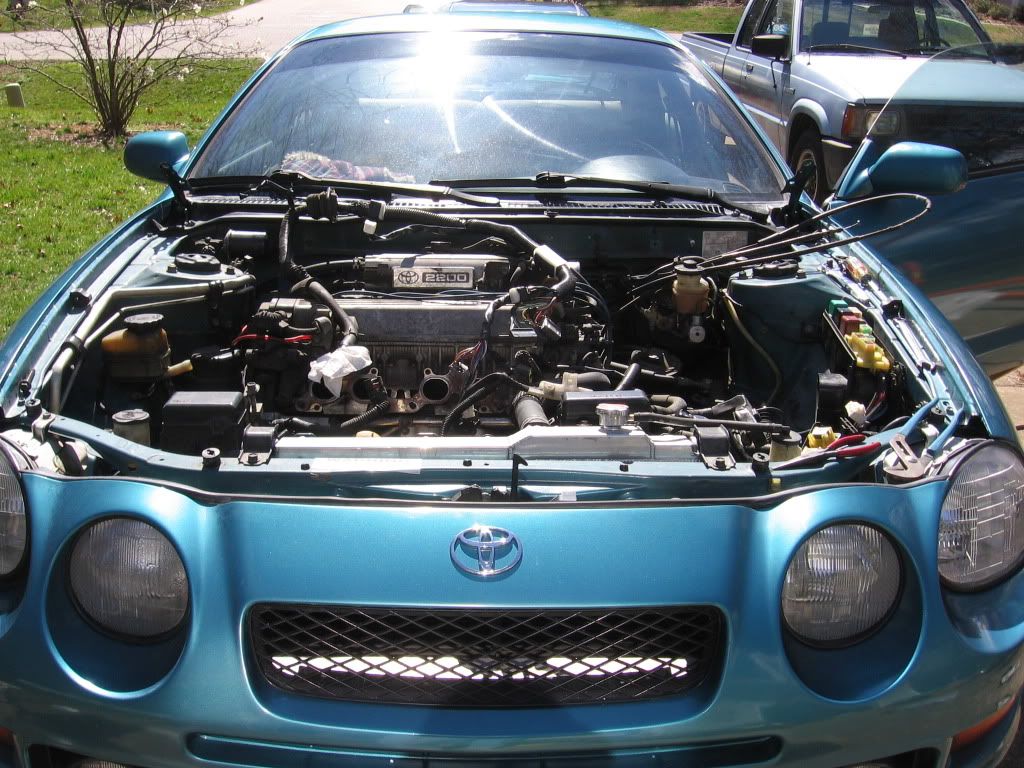

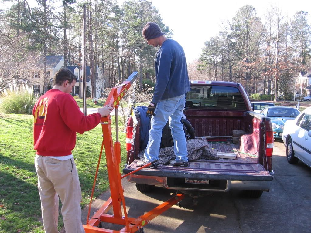

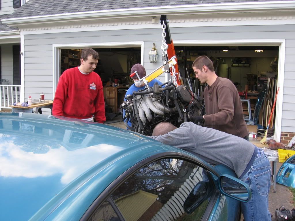

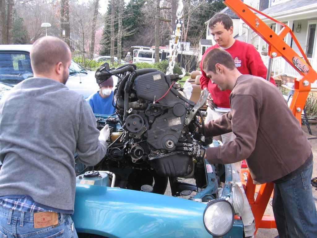

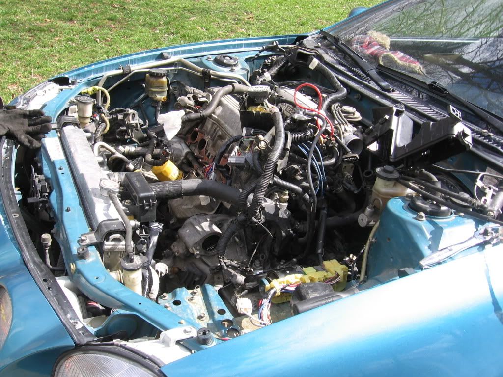

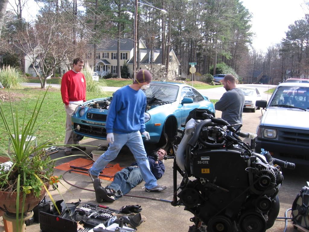

I will try to keep these in order, but there are a BUNCH of pictures.
Prep night in the garage the night before the swap.
I parked the car at the swap location, and this was my mileage.
Special Delivery!
The patient.
Remove hood.
Progress.
Now lean back!
Stupid Axles.
More progress.
More help arrives.
x2
Loose.
Hooked up!
x2
Stupid rear mount! Curtis was PISSED.
Got it!
x2
Almost!
OUT!
Empty!
x2
Tranny off!
Up to bat!
Clutch/Flywheel/Pressure plate INSTALLED!
Those are the last of the pictures for now because it got dark and cold really fast. We will pick up tomorrow.
The transmission is installed on the engine (engine 100% ready to install), walbro installed, ecu installed, hole cut in firewall for wiring, and obviously...5s removed...

Quick question. I went ahead and did this, but i just want to be sure. I took the mount from the back of the 5s that the axle bolts to, and bolted it to the back of the 3s....Is this correct? Or should I somehow find a way to use the 3s mount?
post Feb 25, 2012 - 11:12 PM
Ted95
Joined Mar 8, '09
From Westport, MA
yep the 5s axle bracket works just fine on the 3s, looking good ben!

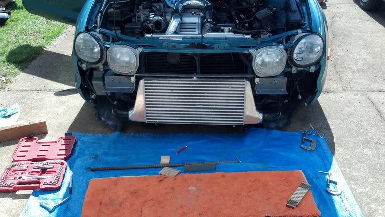

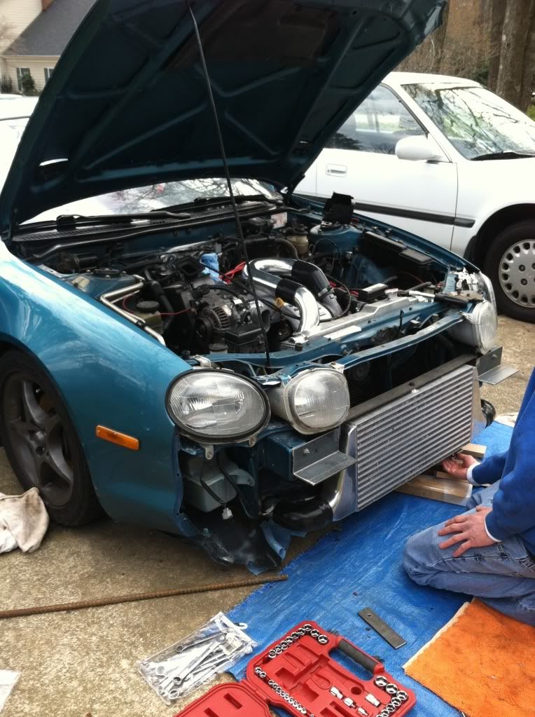

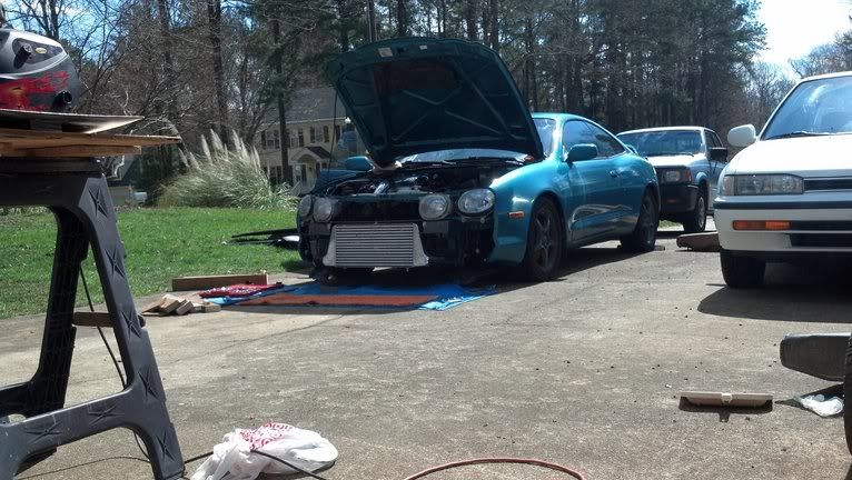

Got the intercooler mounted today, and made a new steel crash bar. I'd feel really bad for the poor sap that hit me. This thing is brutally rigid!
post Mar 4, 2012 - 8:37 PM
Ted95
Joined Mar 8, '09
From Westport, MA
