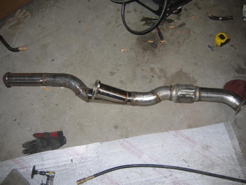

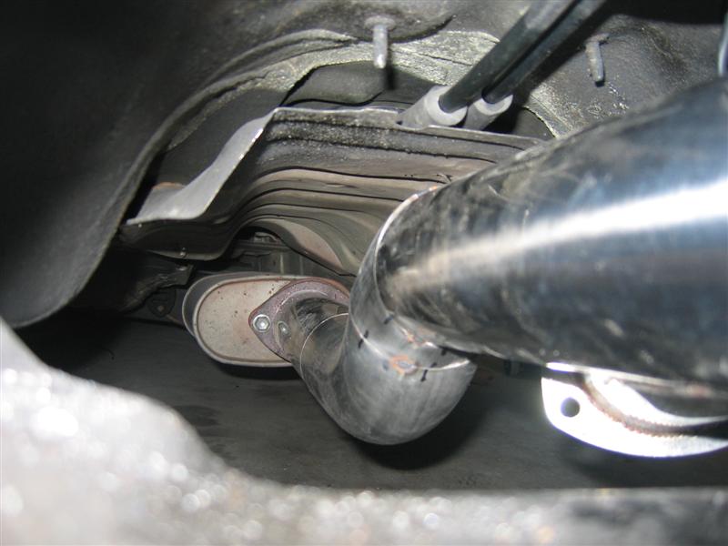

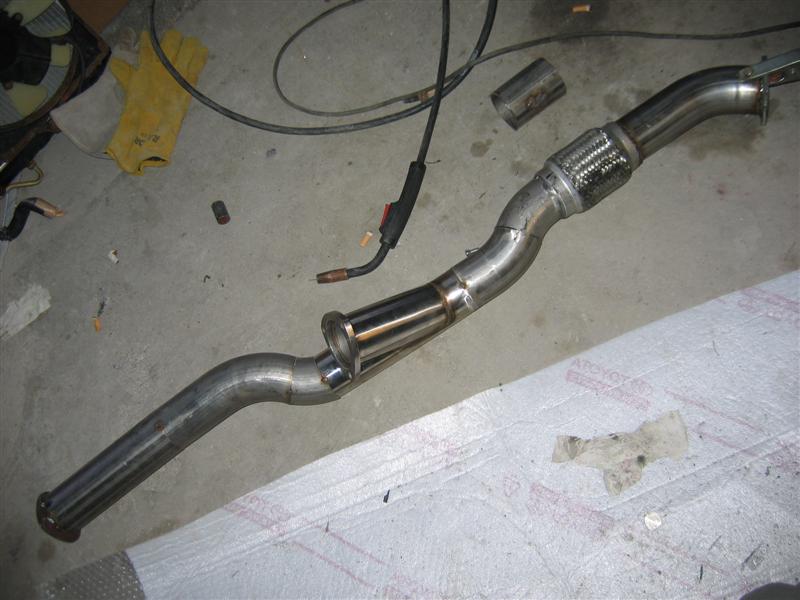

Sunday - day three - the exhaust. I already have a HKS cat-back so Manny made a b pipe - from the berk dp to the HKS.
started with this
and it became...
tacked and almost finished
done and a quick paint job (that got a little scratched when installed). Manny says "I stand by my exhaust"
and a few installed
and the exhaust cut out from Q T P
I have 3" from the turbo to the cat-back (which is 2.5") so as Corey did we installed a butterfly open exhaust valve. I put in a toggle switch so I can open and close the butterfly whenever I want. Quiet cruising with it closed and all the exhaust goes out the back OR I open it up, it gets loud and free flowing exhaust - no restriction biggrin.gif and more BOOST

anyway, dustin posted most of the pics i have, so ill just add a few more of the b-pipe i made him.
im pretty proud of it, the welds arnt pretty, im very much so still learning, but what im more happy with than anything else is the placement and fit of everything.
clearance is good everywhere, and it runs right in the middle of the crossmember and steering rack.
not too bad for my first attempt at making a b-pipe, i think.
this one shows the whole thing tacked, and in place checking fitment. you can see here how it goes up and over the crossmember, and back down to meet the HKS exhaust.
this is a good shot of the crossmember/ PS rack clearance. this is looking back at the exhaust thru the crossmember.
and a couple of it out, first tacked up, then all welded up.
dustin covered the installed shots, and the sweet QTP cutout. which BTW, i think sounds absolutly AWESOME.
and finally, the money shot:
what a way to spend a weekend with friends.
hehe.
btw, D, your welcome man. i know i ribbed ya hard all weekend, but you know how we do. laugh.gif

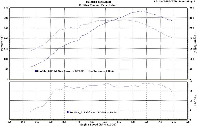

went to the dyno today, I thought Jim was coming up here so we could all go but that didn't happen for some reason. Either way he went in Jersey and I went near me.
my results
19.04psi = 329.62hp & 288.64ft tq

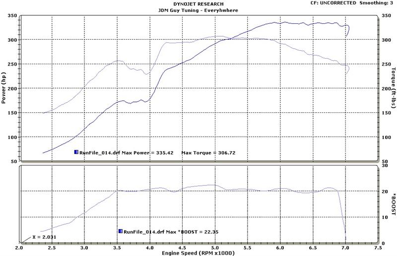

then I turned the boost up a bit and went to this
22.35psi = 335hp & 306.72ft tq
and then with the motor a little warm from the runs I started to knock a bit and decided to shut it down
22.5psi = 330.12hp & 307.91ft tq
FYI I never run my car above 17/18psi on the street, I turned up the boost on the dyno just to see what it can do. In a few weeks I will install WI so runing that much boost will be safer with no knock.
Ba-Zing.
post Feb 8, 2009 - 12:36 AM
it looks like youre running out of fuel.
post Feb 8, 2009 - 8:01 AM
QUOTE (lagos @ Feb 8, 2009 - 12:36 AM) *
art, he had the sniffer in the tailpipe, but had the cutout open, so disregard that a/f chart. wink.gif
great work d!
::edit:: dustin, i hosted the charts on 6gc, with RPM instead of speed, and with the a/f removed, just to avoid confusion.
also a few notes about runs 14 and 18..
you can clearly see the car knock @ ~3600rpm, this is why running this much boost, on pump gas, without WI can get dangerous. especially with a ceramic turbine '20b.
in run 18, you can see the factory ECU at work.
the run is VERY choppy compared to the earlier runs, due to the stock ecu still recovering from the earlier knock event in run 14. run 18 is also a 4th gear run the earlier runs were in 3rd gear.
with the boost log, you can also see how much better the wastegate holds on jims runs VS these, its quite inconsistant, where jims boost log is perfect all the way to redline.

yea, i told him to take the a/f out, before he posted to avoid that, but then again, we were pretty drunk last night...lmao

Great numbers Dustin, please send me the run files when you get a chance. I would like to pick through them. Thanks. You should make an adapter for your tip so you can block off the muffler so you can install the WB into the exhaust cutout, at keast this way you can log AF.
You can see the advantages of WI between my run and Dustins run. Dustin did not make any more power by throwing another 3psi, where mine contentiously made more power as I turned up the boost. I cant wait to go back to the dyno it was a great experience, and I wouldn't have changed ANYTHING about the way it went down. I got the car all setup the way I wanted, under my conditions, my time, met some great people, a VERY knowledgeable dyno operator/tuner and had a great time doing it.
Dustin, If you have the will power to do it, it only took me a few hours total to add the helper spring and I am very pleased how it turned out. It helped me through out the entire Boost range. Even 16psi was dead flat, I highly recommended it. thumbsup.gif
330whp 309ft/lbs @ 21 PSI

Yeah I was a little drunk last night and I've been fighting the flu but a night of drinking at Manny's made me feel much better thumbsup.gif
The helper spring is a good idea if I plan on running 19+psi often but I'm not, I'm content with the way it is. There are a few things I should of done better like letting the car/IC cool down a bit more between runs or stepping the boost up little by little for a good comparison of power with psi. Overall I'm wicked happy with the results and I now know I should get WI asap to avoid knock.
I know I could of made more than the 335 to the wheels but it was getting dangerous without WI.
